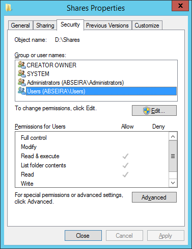

First, create a shared folder on the network, granting all clients "Read" permissions and "Read & Execute" NTFS permissions. For example, name this folder \SRVR2012\Shares, or use the server's IP address. Inside the "Shares" folder, create an "AIDA64" subfolder and copy the contents of the ZIP package downloaded from the AIDA64 website into this subfolder.

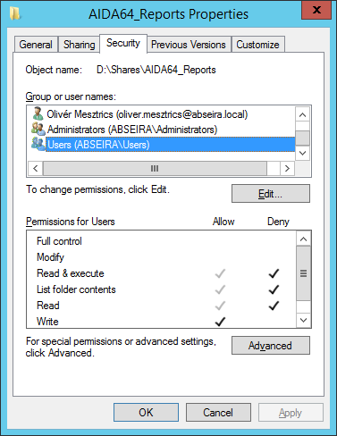

If you choose to store reports collected from client computers in individual files instead of a database, create a folder with "Write" NTFS permissions for all clients. For example, name this folder \SRVR2012\Shares\AIDA64_Reports. AIDA64 running on the clients will be able to copy the reports to this location. Ensure that any inherited "Read and Execute" permissions for clients are revoked.
